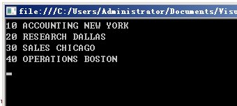

  1. using System;
  2. using System.Collections.Generic;
  3. using System.Linq;
  4. using System.Text;
  5. using Oracle.ManagedDataAccess.Client;
  6. using System.Data;
  7. namespace ConsoleApplication1
  8. {
  9.     class Program
  10.     {
  11.         static void Main(string[] args)
  12.         {
  13.             try
  14.             {
  15.                 string constr = "user id=scott;password=tiger;data source=//127.0.0.1/ORCL";
  16.                 OracleConnection con = new OracleConnection(constr);
  17.                 con.Open();
  18.                 OracleCommand cmd = con.CreateCommand();
  19.                 cmd.CommandText = "SELECT DEPTNO, DNAME, LOC FROM DEPT";
  20.                 IDataReader dr = cmd.ExecuteReader();
  21.                 while (dr.Read())
  22.                 {
  23.                     Console.WriteLine("{0} {1} {2}", dr.GetValue(0),dr.GetValue(1),dr.GetValue(2));
  24.                 }
  25.                 dr.Close();
  26.                 cmd.Dispose();
  27.                 con.Dispose();
  28.                 Console.ReadLine();
  29.             }
  30.             catch (Exception ex)
  31.             {
  32.                 Console.WriteLine("Error : {0}", ex);
  33.             }
  34.         }
  35.     }
  36. }
