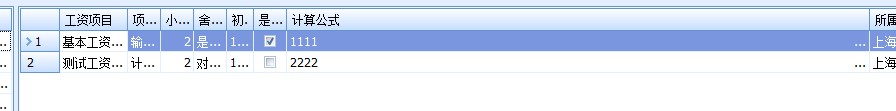

如下图:
代码如下:
string sql = "SELECT ltrim(rtrim(gzxm )) as 工资项目 ,ltrim(rtrim(xmlx)) as 项目类型 ,ltrim(rtrim(xsws)) as 小数位数 ,ltrim(rtrim(swfs)) as 舍位方式 ,ltrim(rtrim(init)) as 初始值 ,ltrim(rtrim(isshow)) as 是否显示 ,ltrim(rtrim(Formula)) as 计算公式 ,ltrim(rtrim(ztname))  as 所属帐套 from 工资项目 where ztname='" + see + "'";
                //MessageBox.Show(sql);
                DataSet ds2 = Maticsoft.DBUtility.DbHelperSQL.DateSetQuery(sql);
                DataTable dt2 = new DataTable();
                dt2 = ds2.Tables[0];
                gridControl2.DataSource = dt2;
                gridView2.BestFitColumns();
                this.gridView2.Columns["工资项目"].Width = 20;
                this.gridView2.Columns["项目类型"].Width = 20;
                this.gridView2.Columns["小数位数"].Width = 15;
                this.gridView2.Columns["舍位方式"].Width = 20;
                this.gridView2.Columns["初始值"].Width = 20;
                this.gridView2.Columns["是否显示"].Width = 10;
                this.gridView2.Columns["计算公式"].Width = 40;
                this.gridView2.Columns["所属帐套"].Width = 30;
请各位帮忙看一下

根据你所描述的问题,devexpress中的gridControl控件默认是自动列宽的,所以建议你gridview右键属性里面设置ColumnAutoWidth设置为false,这个问题应该可以解决。
有这个就行了

谢谢二位兄弟,发现问题了,字段设置的问题
