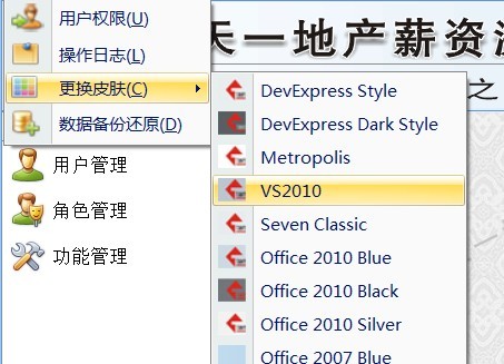

发表于 2013-6-26 17:52:41 | 显示全部楼层 |阅读模式
1.首先添加DevExpress.OfficeSkinsDevExpress.BonusSkins 两个引用。
在Main()函数之前进行皮肤注册:
  1. static class Program
  2. {
  3. /// <summary>
  4. /// 应用程序的主入口点。
  5. /// </summary>
  6. [STAThread]
  7. static void Main()
  8. {
  9. DevExpress.UserSkins.BonusSkins.Register();//皮肤注册
  10. DevExpress.UserSkins.OfficeSkins.Register();
  11. DevExpress.Skins.SkinManager.EnableFormSkins();//激活窗体皮肤,否则窗体还是操作系统默认主题风格
  12. DevExpress.LookAndFeel.UserLookAndFeel.Default.SkinName = "Blue";
  13. Application.EnableVisualStyles();
  14. Application.SetCompatibleTextRenderingDefault(false);
  15. Application.Run(new XtraForm1());
  16. }
  17. }
复制代码
2.添加一个父窗体,加一个全局静态DefaultLookAndFeel 成员控制皮肤,其他所有的窗体都继承该父窗体。
  1. public partial class frmBase: DevExpress.XtraEditors.XtraForm {
  2.     private static DefaultLookAndFeel gLobalDefaultLookAndFeel = new DefaultLookAndFeel();
  3.     public static DefaultLookAndFeel GLobalDefaultLookAndFeel {
  4.         get {
  5.             return frmBase.gLobalDefaultLookAndFeel;
  6.         }
  7.         set {
  8.             frmBase.gLobalDefaultLookAndFeel = value;
  9.         }
  10.     }
  11.     public frmBase() {
  12.         InitializeComponent();
  13.     }
  14. }
复制代码

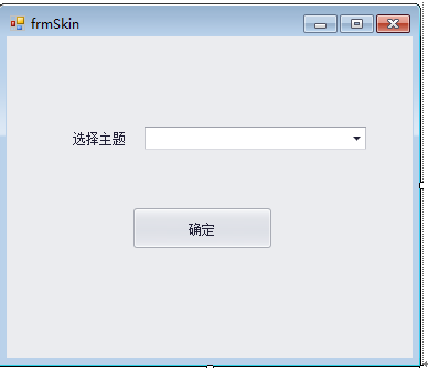

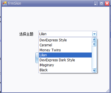

3.添加一个控制皮肤的窗体frmSkin:
  1. public partial class frmSkin: DevExpress.XtraEditors.XtraForm {
  2.     public frmSkin() {
  3.         InitializeComponent();
  4.     }
  5.     private void frmSkin_Load(object sender, EventArgs e) {
  6.         foreach(DevExpress.Skins.SkinContainer skinc in DevExpress.Skins.SkinManager.Default.Skins) {
  7.             cboSkins.Properties.Items.Add(skinc.SkinName);
  8.         }
  9.     }
  10.     private void cboSkins_SelectedIndexChanged(object sender, EventArgs e) {
  11.         frmBase.GLobalDefaultLookAndFeel.LookAndFeel.SkinName = cboSkins.Text;
  12.     }
  13.     private void btnOK_Click(object sender, EventArgs e) {
  14.         this.Close();
  15.     }
  16. }
