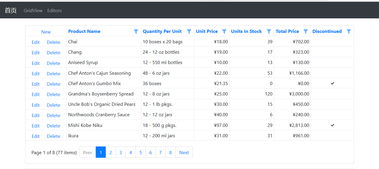

修改Startup.cs
[C#] 纯文本查看 复制代码
            services.AddMvc();            //使用DevExpress 服务
            services.AddDevExpressControls();
            //使用Sqlite 数据库
            services.AddDbContext<DevExpressStarterProject.Models.NorthwindContext>(options => {
                options.UseSqlite(Configuration.GetConnectionString("NorthwindConnection"));
使用AJAX控件
在SampleController定义四个回调方法
[C#] 纯文本查看 复制代码
        public IActionResult GridViewPartial() {
            return PartialView(NorthwindContext.Products);
        public IActionResult AddNewRow(Product product) {
            try {
                if(ModelState.IsValid) {
                    product.ProductID = NorthwindContext.Products.Max(p => p.ProductID) + 1;
                    NorthwindContext.Products.Add(product);
                    NorthwindContext.SaveChanges();
            } catch(Exception e) {
                ViewData["error"] = e.Message;
            return PartialView("GridViewPartial", NorthwindContext.Products);
        public IActionResult UpdateRow(Product product) {
            try {
                    NorthwindContext.Products.Update(product);
        public IActionResult DeleteRow(int productID = -1) {
            var product = NorthwindContext.Products
                .FirstOrDefault(i => i.ProductID == productID);
            try {
                NorthwindContext.Products.Remove(product);
将控件的Razor代码添加到创建的局部视图中。为新操作方法指定AJAX请求路由映射:
[C#] 纯文本查看 复制代码
@(Html.DevExpress()
    .BootstrapGridView<Product>("GridView")
    .KeyFieldName(m => m.ProductID)
    .Columns(columns => {
        columns.AddCommandColumn()
            .ShowEditButton(true)
            .ShowNewButtonInHeader(true)
            .ShowDeleteButton(true);
        columns.Add(m => m.ProductName);
        columns.Add(m => m.QuantityPerUnit);
        columns.Add(m => m.UnitPrice);
        columns.Add(m => m.UnitsInStock);
        columns
           .AddTextColumn()
           .FieldName("TotalPrice")
           .ReadOnly(true)
           .UnboundType(DevExpress.Data.UnboundColumnType.Decimal)
           .UnboundExpression("UnitPrice * UnitsInStock")
           .PropertiesTextEdit(properties => properties.DisplayFormatString("c"))
           .SettingsEditForm(editForm => editForm.Visible(false));
        columns.Add(m => m.Discontinued);
    .Settings(settings => settings.ShowHeaderFilterButton(true))
    .EditErrorText(ViewData["Error"]?.ToString())
    .Routes(routes => routes
       .MapRoute(r => r
           .Action("GridViewPartial")
           .Controller("Sample"))
       .MapRoute(r => r
           .RouteType(GridViewRouteType.UpdateRow)
           .Action("UpdateRow")
       .MapRoute(r => r
           .RouteType(GridViewRouteType.AddRow)
           .Action("AddNewRow")
       .MapRoute(r => r
           .RouteType(GridViewRouteType.DeleteRow)
           .Action("DeleteRow")
           .Controller("Sample")))
    .Bind(Model))

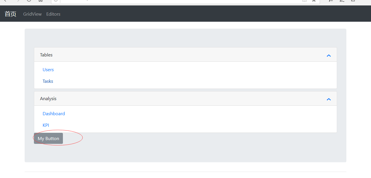

自定义控件的外观
套件中的每个控件都有一个CssClasses方法,通过设置该方法改变控件外观
先添加样式代码
[size=1em]CSS
.my-button {    border-radius: 0;}
生成一个按钮控件并指定样式。
[size=1em]C#
@(Html.DevExpress()    .BootstrapButton("myButton")    .CssClasses(css => css.Control("my-button"))    .Text("My Button")
