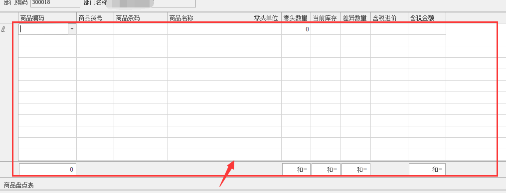

dev控件,gridcontrol控件默认空白区域是空的,以下源代码为控件空白区域画风格线。
不同的皮肤可能会出现偏差,测试vs2019以后新增的皮肤,本实例以dev18.2为例,如果需要可调整下段代码:
  int minRowHeight = e.ViewInfo.View.RowHeight + 1;// .MinRowHeight;
            if (e.ViewInfo.View.RowHeight == -1)
                minRowHeight = e.ViewInfo.MinRowHeight + 1;
            if (base.View.OptionsView.ShowHorzLines)
                for (int i = top; i <= bottom; i += minRowHeight)
                    e.Graphics.DrawLine(pen, left, i - 1, right, i - 1);
