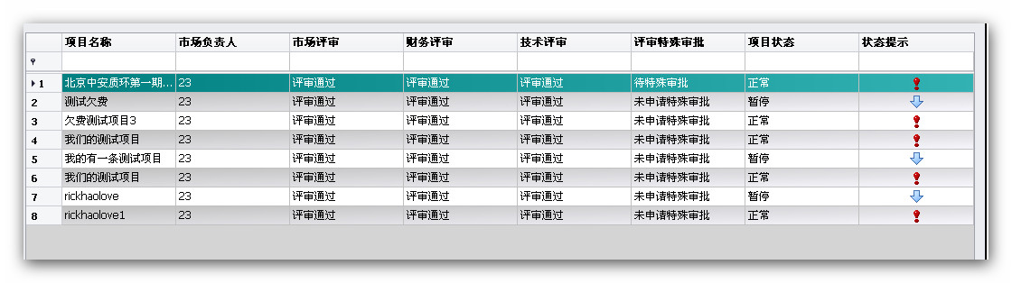

实现步骤:
第一步:
RepositoryItemPictureEdit repositoryItemPictureEdit1 = this.gridControl1.RepositoryItems.Add("PictureEdit") as RepositoryItemPictureEdit;
GridColumn unbColumn = this.gridView1.Columns.AddField("状态提示");
unbColumn.UnboundType = DevExpress.Data.UnboundColumnType.Object;
unbColumn.VisibleIndex = this.gridView1.Columns.Count - 1;
unbColumn.ColumnEdit = repositoryItemPictureEdit1;//设置非绑定列的动画的现实模式,非为始终现实动画、为焦点时显示动画及默认
this.gridView1.OptionsView.AnimationType = GridAnimationType.AnimateAllContent;
repositoryItemPictureEdit1.NullText = " ";  //解决了自动筛选行显示“No image data”的问题
第二步
        private void gridView1_CustomUnboundColumnData_1(object sender, CustomColumnDataEventArgs e)
                if (e.IsGetData)
                    DataRow row = gridView1.GetDataRow(e.RowHandle);
                    if (row == null) return;
                    //这只根据"QYBH"列的值,来返回不同的图片
                    string key = (string)row["xmzt"];        //根据 "xmzt"这一列来显示不同的图片
                    if (this.gridView1.RowCount >= 0)
                        if (key == "正常")
                            if (!ht.ContainsKey(key))      //看看ht表里面是否包含当前键值,哈希表就是相当于一个键值对表
                                ht.Add(key, GetImage(0));
                            e.Value = ht[key];
                        else if (key == "暂停")
                                ht.Add(key, GetImage(1));
                            e.Value = ht[key];
第三步
       private Hashtable ht = new Hashtable();
        private byte[] GetImage(int key)
            //根据传过来的值,返回相应的图片,
            Image img = null;
            if (key==0)
                img = Properties.Resources.high;
            else if(key==1)
                img = Properties.Resources.low;
            return DevExpress.XtraEditors.Controls.ByteImageConverter.ToByteArray(img, ImageFormat.Gif);

发表于 2015-6-17 17:04:32 | 显示全部楼层
太复杂了,只有用数据更和imagelist绑定一下就行了
