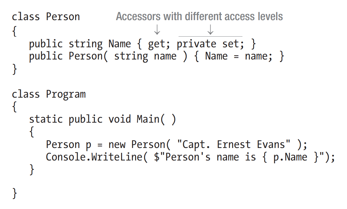

最近在看图解C#这本书,里面有一个章节:“6.18 访问器的访问修饰符”源代码:
因为我之前看的时候,说是属性没有内存空间,一般是关联字段进行存取。
但是看这个案例里面,Name这个属性直接就用了。我比较疑惑,有人可以解释下吗?
33
93
2021-4-29
 楼主| 发表于 2021-5-17 15:20:44 | 显示全部楼层
往前翻书自己找到原理了,“自动实现属性”会隐式创建字段关联属性。
Automatically Implemented Properties—Auto-properties
Because properties are so often associated with backing fields, C# provides automatically implemented
properties, also called auto-implemented properties or, more commonly, just auto-properties, which allow
you to declare the property without declaring a backing field. The compiler creates a hidden backing field for
you and automatically hooks up the get and set accessors to it.
