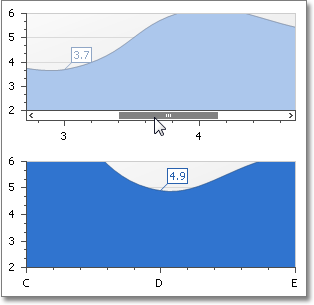

本示例展示了如何沿所需的轴分别调整轴的滚动。 使用有两个 窗格 的图表来演示此功能。
C# | ![]() |
using System.Windows.Forms; using DevExpress.Utils; using DevExpress.XtraCharts; // ... private void Form1_Load(object sender, EventArgs e) { // Cast the chart's diagram to the XYDiagram type, to access its axes. XYDiagram diagram = (XYDiagram)chartControl1.Diagram; // Define the visible range for the axes. diagram.AxisY.Range.Auto = false; diagram.AxisY.Range.SetInternalMinMaxValues(2, 6); diagram.AxisX.Range.Auto = false; diagram.AxisX.Range.SetInternalMinMaxValues(2, 4); diagram.SecondaryAxesX[0].Range.Auto = false; diagram.SecondaryAxesX[0].Range.SetInternalMinMaxValues(2, 4); // Specify the axes scrolling at the diagram's level. diagram.EnableAxisXScrolling = true; diagram.EnableAxisYScrolling = false; // Individually specify the axes scrolling for the panes. diagram.DefaultPane.EnableAxisXScrolling = DefaultBoolean.Default; diagram.Panes[0].EnableAxisXScrolling = DefaultBoolean.False; // Adjust how the scrolling can be performed. diagram.ScrollingOptions.UseKeyboard = false; diagram.ScrollingOptions.UseMouse = false; diagram.ScrollingOptions.UseScrollBars = true; } |
Visual Basic | ![]() |
Imports System.Windows.Forms Imports DevExpress.Utils Imports DevExpress.XtraCharts ' ... Private Sub Form1_Load(ByVal sender As Object, _ ByVal e As EventArgs) Handles MyBase.Load ' Cast the chart's diagram to the XYDiagram type, to access its axes. Dim diagram As XYDiagram = CType(chartControl1.Diagram, XYDiagram) ' Define the visible range for the axes. diagram.AxisY.Range.Auto = False diagram.AxisY.Range.SetInternalMinMaxValues(2, 6) diagram.AxisX.Range.Auto = False diagram.AxisX.Range.SetInternalMinMaxValues(2, 4) diagram.SecondaryAxesX(0).Range.Auto = False diagram.SecondaryAxesX(0).Range.SetInternalMinMaxValues(2, 4) ' Specify the axes scrolling at the diagram's level. diagram.EnableAxisXScrolling = True diagram.EnableAxisYScrolling = False ' Individually specify the axes scrolling for the panes. diagram.DefaultPane.EnableAxisXScrolling = DefaultBoolean.Default diagram.Panes(0).EnableAxisXScrolling = DefaultBoolean.False ' Adjust how the scrolling can be performed. diagram.ScrollingOptions.UseKeyboard = False diagram.ScrollingOptions.UseMouse = False diagram.ScrollingOptions.UseScrollBars = True End Sub |
在下面的插图中显示了结果。
